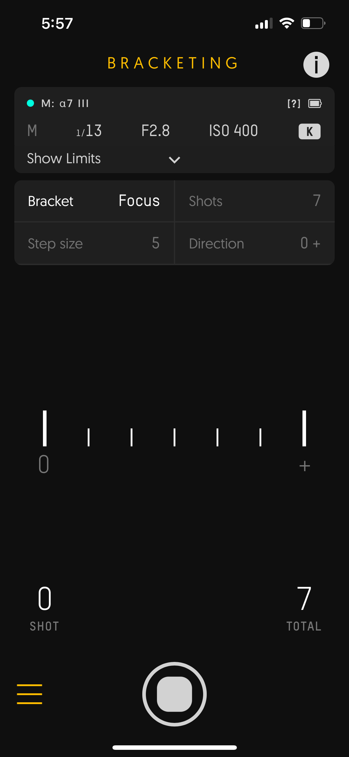

Focus bracket is not working on Unleashed 22 for Sony A7III. 99% of the time there is no picture taken and the app does not show a photo being taken. Occasionally one shot will be triggered but focus does not change. App and camera is still responsive during this. Changing step size, # shots, or direction does not change behavior.
Focus mode: manual
USB settings: PC Remote
Still Img. Save Dest.: PC+Camera
RAW+J PC Save Img = JPEG Only
Sony FW: 4.01
Unleashed 22 FW: A 3.1.1, B 3.1.0, C 3.1.0

Unfortunately, I'm updated to A: 3.2.0, B: 3.2.0, C: 3.1.0 and there's no change to the Focus Bracketing behavior that I'm seeing. I can trigger in the app, the shutter button stays pressed down and eventually resets. No photo is taken, no change in focus position, and the app is still responsive. Exposure bracketing appears to be working great however!
Example of button staying pressed:

I'm in MF. Single shot. Raw+jpg.
Any other mode states "Bracketing trigger is not available. Focus mode is MF. Change focus mode." - Just realizing that might be a typo? Should probably say "Focus mode is AF"?
