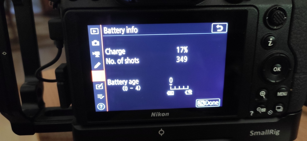

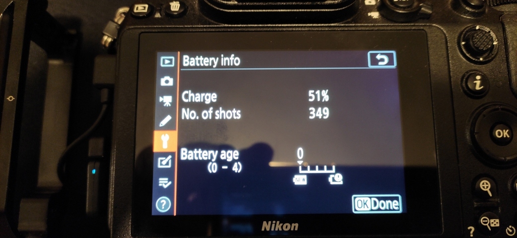

I still get battery drain with latest firmware on my Z6.
From 2023.11.04 22:33 till 2023.11.06 08:40 the battery went from 51% to 17%.
During this time the camera was turned off.
