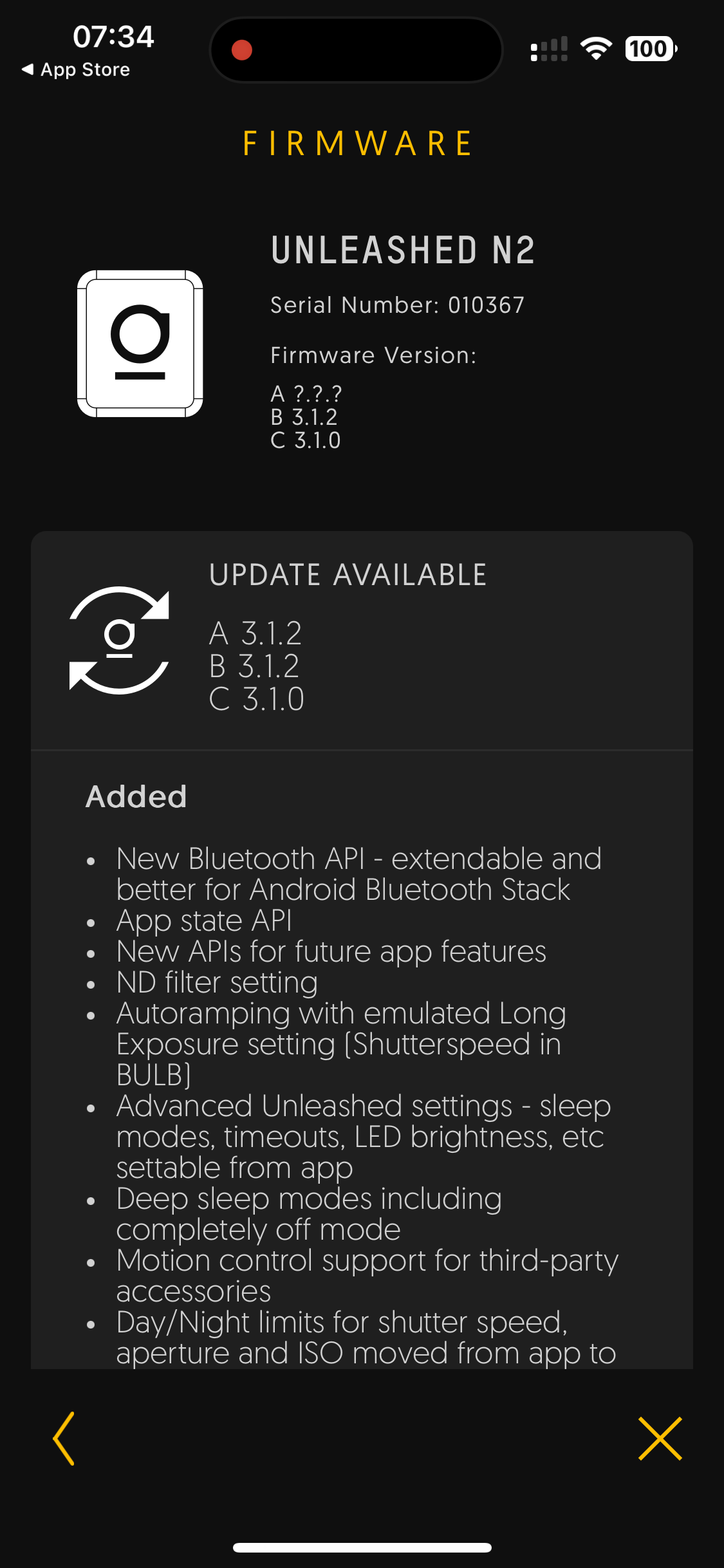

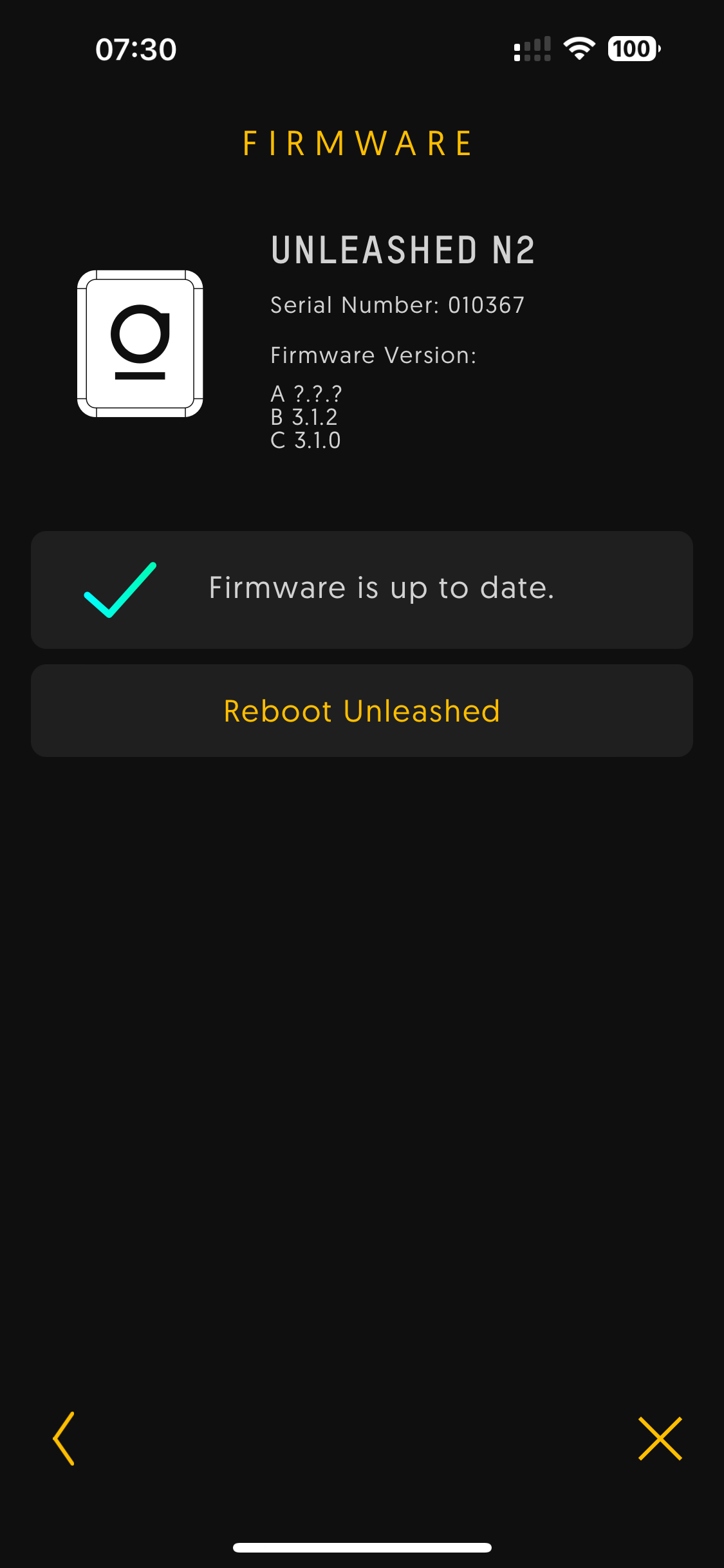

I’m just stuck in an endless loop of the App says there is a Firmware update, I press install, I didn’t get a spinning circle or percentage of the update just a few seconds it said updated but it’s not I still have FW A as ?.?.? (3 question marks ❓ ) but no beta 255 now, the app says there new update is available and around and around I go.
Clearly the U22N2 is no good! Right???
Oliver , I have call your office to try and get someone help or recognise that there isn’t anymore that I can do, how do I get a replacement? Based on 11 months of waiting for the pledge product, I’m not hopeful of seeing a replacement in the next 4-6 months.
FW still won’t update U22N2 device is useless

Hi Keltyinnty
With the Unleashed showing ?.?.? for Firmware A, that means that either the firmware update did not actually work, or that there is something seriously wrong - we found a case where the Microcontroller A would produce so much internal traffic that nothing else would get through, not even enough to communicate its own firmware version. This was fixed in FW A3.1.2.
Unfortunately, we also had a bug in our iOS App, which assumed ?.?.? was a higher version than 3.1.2, so it would not offer you an update (as shown in your screenshot. We've done a few more releases since - the last one (3.2.0) just yesterday! So that should show up and let you install it. The updated iOS app is currently in review at Apple, and will be released in the next few days.
the ?.?.? will definitely lead to all sorts of trouble - limited to no functionality and battery drain too. So that would be expected.
Could you specify what you mean by this?
"At this stage the U22N2 works somewhat"
Does it only partially work? what's not working? Partial functionality might explain the battery drain issue, so please be as specific as you can, so that we have a chance of fixing it.
