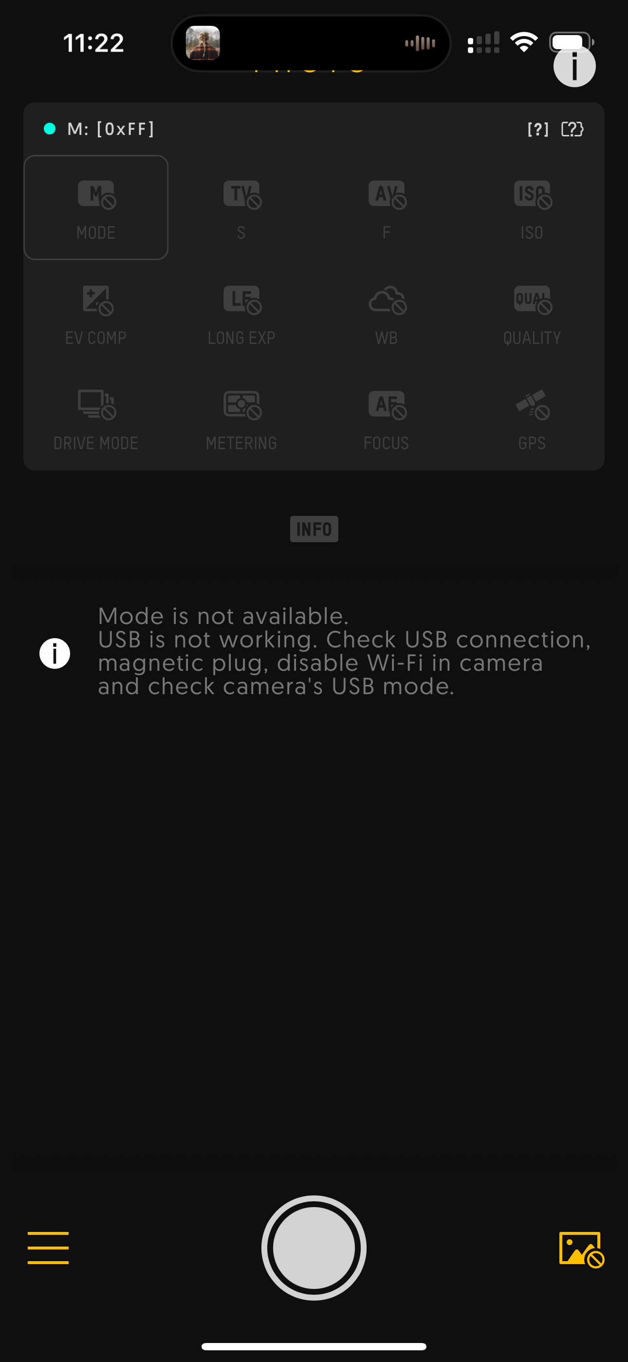

November 5th, 2023, 12:23 pm
Please see screenshot
November 12th, 2023, 12:31 am
Yesterday, we published a firmware update (A3.1.1 B3.1.0) - could you check if this solves your issue?
