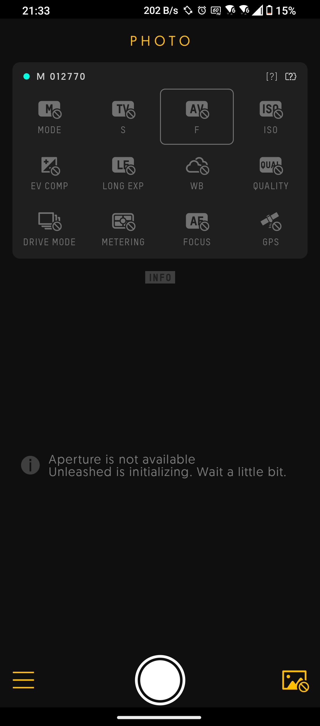

Removed memory card still the same problem.
Can't shut off camera, it hangs, and as you can see in Unleashed app settings not possible and when touch anything het the message "still initializing please wait"

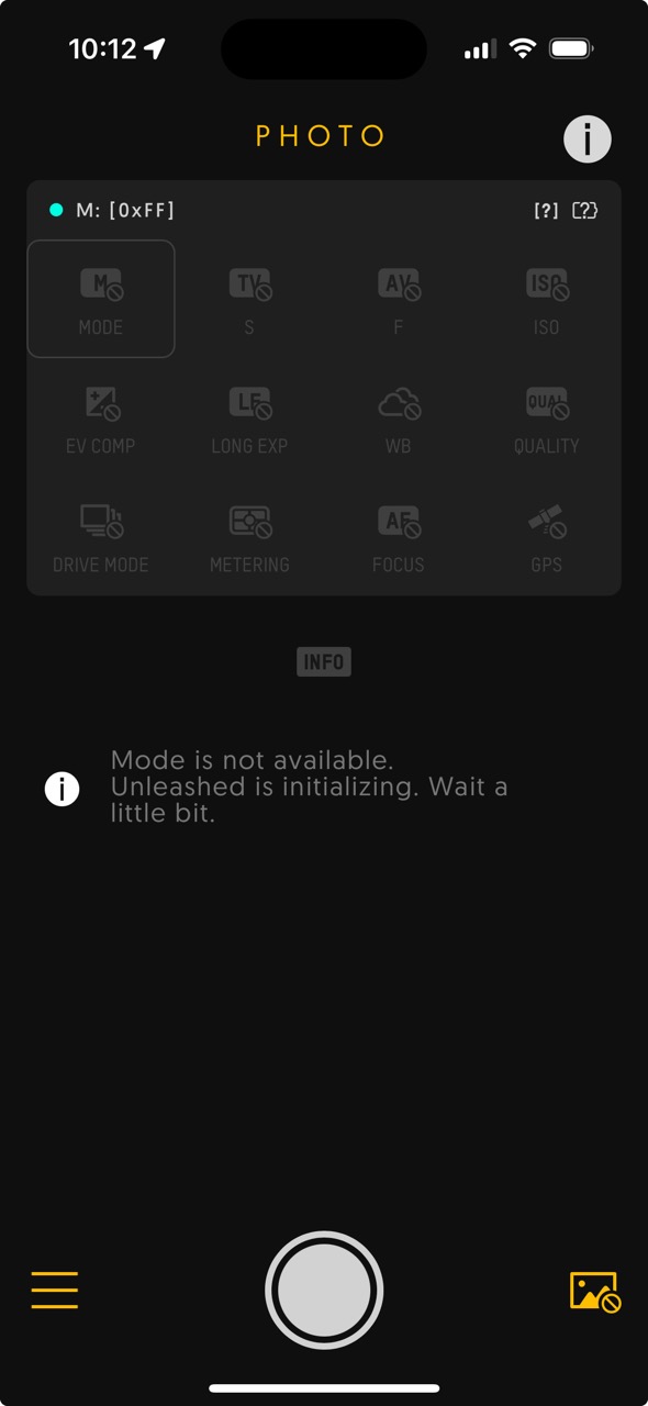

I did the firmware update but it looks really weird as the problem doesn't looks solved.
Camera is freezing and the only solution is to take out the battery.
Groß (Bildschirmfoto 2023-11-02 um 10.12.22).jpeg (47.32 KiB) Viewed 138816 times
