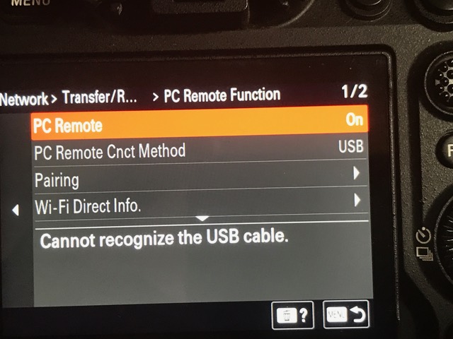

Got my M day before yesterday, but I can't get it to work on my Sony A7IV. I can connect successfully between Unleashed and app, but all icons are greyed out. I've got a message into Foolography tech support, but I think they are swamped.
I've matched my camera settings to those described here:
Rebooting camera and phone, and disconnecting and re-connecting the Unleashed had no effect (and I've flipped the USB-C connector).
The only error message I've found that seems to indicate a trackable problem is this one: "Cannot recognise the USB cable".
Have any other A7IV owners gotten this message?
Many thanks in advance for any insights,
Chas

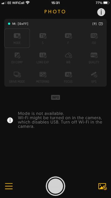

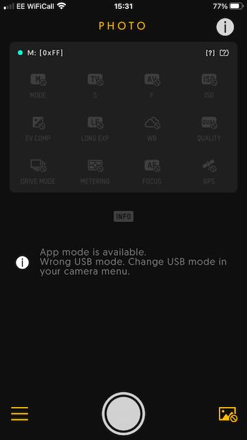

Can you send a screenshot of the app, when you tap on one of the greyed out settings?

October 4th, 2023, 11:51 pm
I sent a very comprehensive email (screenshots, tests etc) to your colleague Natasha on September 29, would you like me to reproduce it here? If you DM me, I can give you the email address I used to send it.
But to address your direct questions: firmware update completed successfully, though it took a few attempts. That photo of my A7IV's screen was taken after the update completed.
And here are two relevant app screenshots:
Glad to have you looking at my problem, as I'm very eager to become properly unleashed :-)

If you can - please try by resetting the camera to factory defaults and try again.
Thanks
November 3rd, 2023, 11:41 pm
We published a firmware update that improves the USB connection. Could you try it to see if it fixes your issue?
