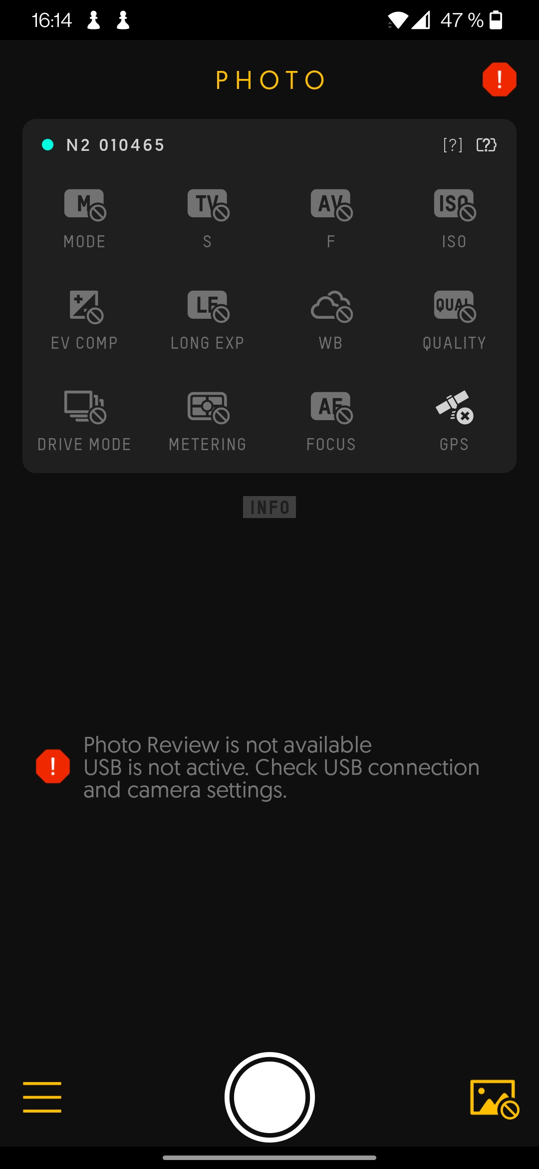

I have problems with the usb connection from the camera to the module.
I need help!
Have anybody the same problems?

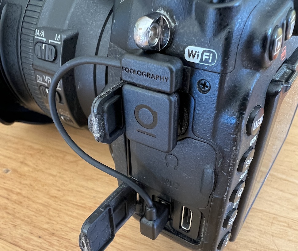

Have you only plugged the UNLEASHED into the camera or have you also plugged the USB cable?

Yes i have placed the cable!
