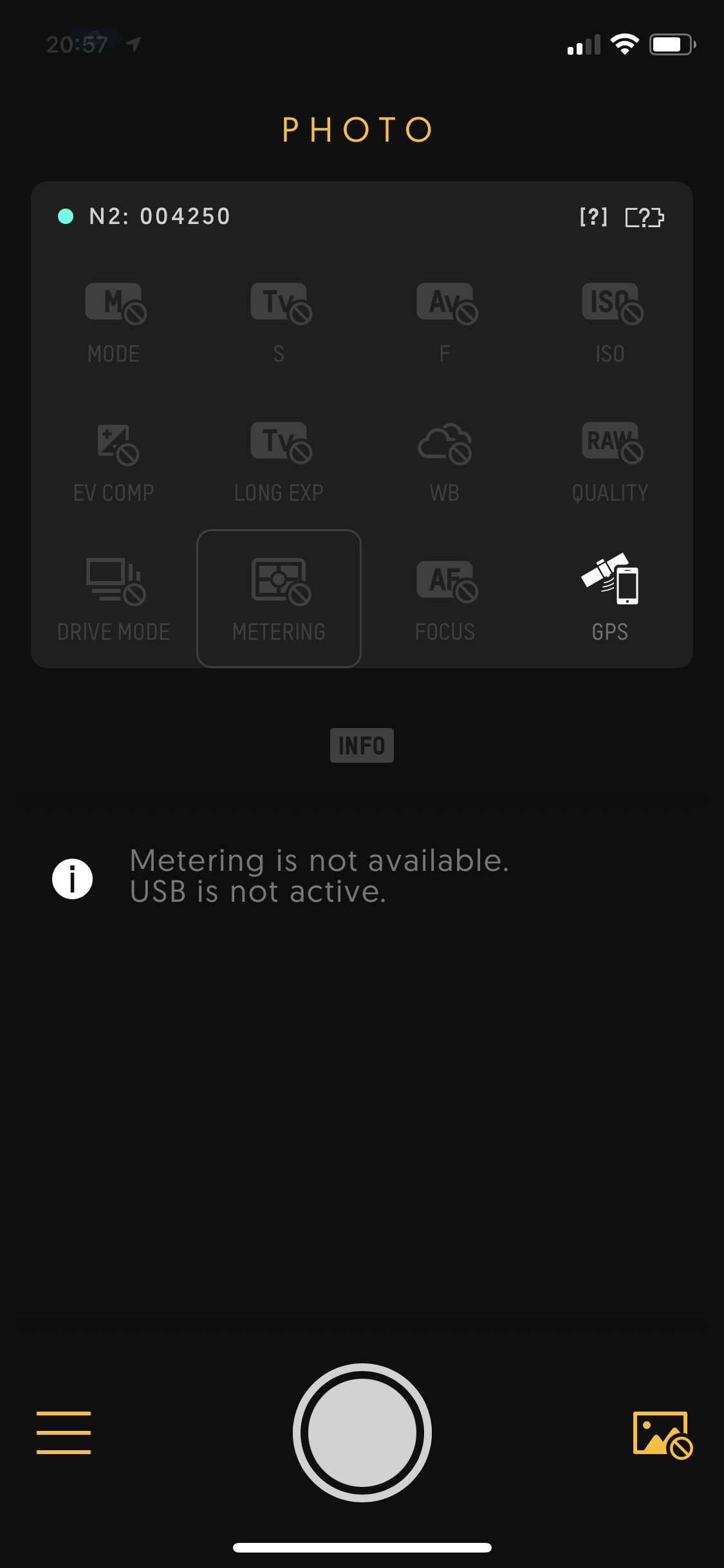

Received my Unleashed N2 for the Nikon D90 today. Unfortunately I'm unable to change any of the camera settings with the app on my iphone.
I can see the GPS works and taking a photo works (nicely includes geotag), but I cannot change any of the phone settings or preview a photo.
What's wrong?

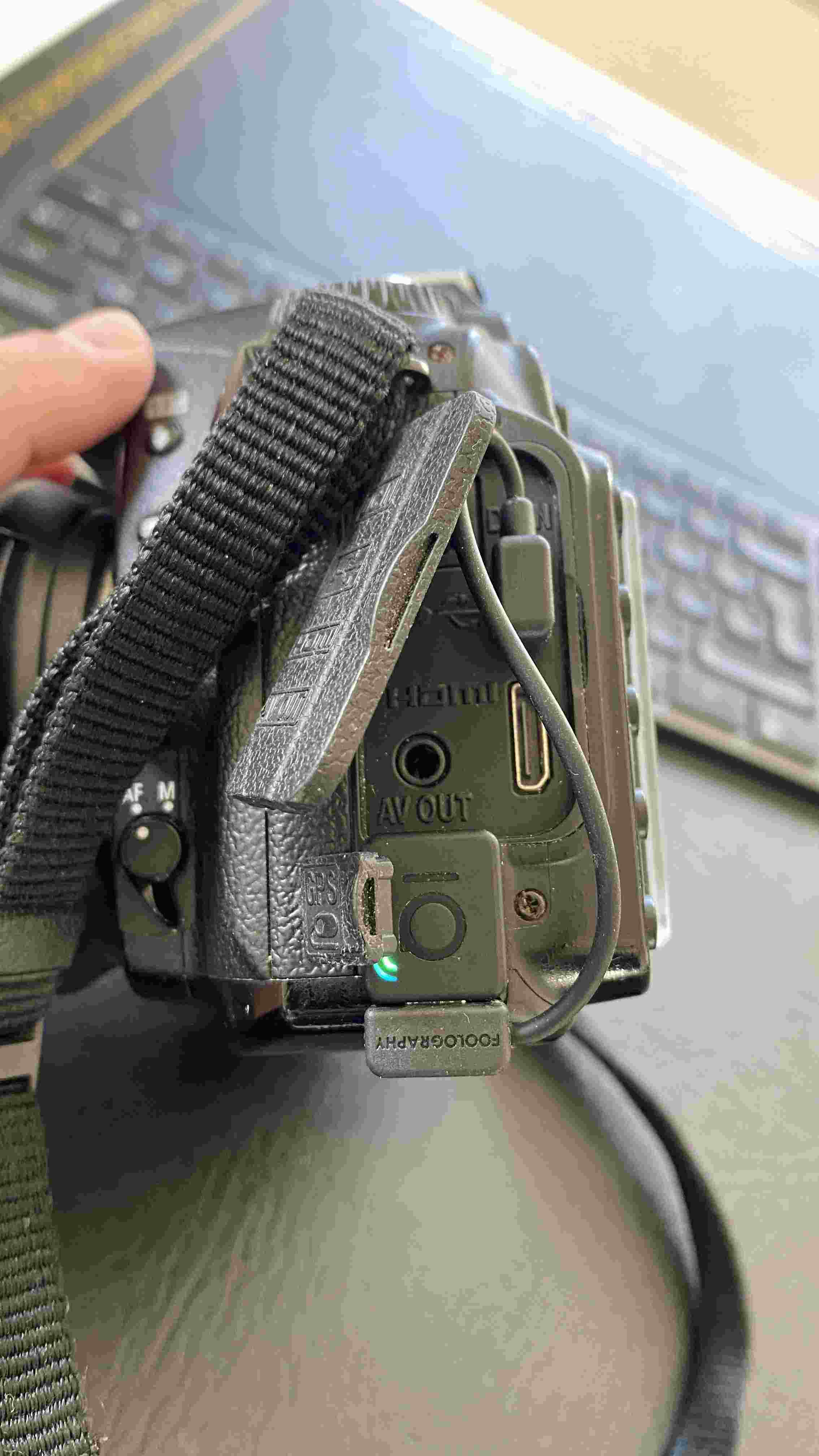

Probably the USB cable reversed in the D90? The GPS port is 180 degrees turned in this camera model. The cable must be pointing - at the Unleashed side - to the back of the camera body, thus not towards the lens.

If you tap on one of the greyed out settings, you'll see a reason why it's read-only or not available.
Tell us what it says, and we can help you more specifically.

The N2 sits upside down indeed with cable facing the back so not towards the Lense.
Tapping on the grayed out settings give nothing except for the metering one. Then the feedback is ‘metering is not available. USB is not active.

Could you make a snapshot of the App screen on your smartphone to see what options are grayed out? Press volume down + power button at the same time to make a snapshot/screenshot.
Post it here with the upload feature in this forum thread. Then we know more.

Error doesn't change when I unplug the USB cable from the unleashed. It stays at: " USB is not active"
Firmware of the unleashed is latest version according to the app. A 1.4.7, B 1.4.10, C 1.4.2
I am using an iphone, so yes on IOS (14.4). Happy to participate in the beta (assuming we get the unleashed to work)
printscreen of the app attached.

Notice anything? I see from the screenshot of the App that the App has not as name the name of the camera (should be N2:D90, not N2:004250). To me this COULD mean that the USB cable is incorrectly installed. I am not saying it is, but could be.
Could you make a photo with your iPhone of the D90 with the Unleashed N2 connected, including the USB cable attached. Maybe that is the problem. I had this problem when I still had my D90, before it finally gave up the ghost due to mirror-of-death problem (mirror stuck for good).
The App should report N2:D90!

Photo attached.
I'll also send my app store email in a separate email as requested .
One additional observation. If the USB cable is plugged in between the unleashed and the D90 the D90 display behaves out of the ordinary. It switches off afer a few seconds regardless if menu options are being selected or previewing a photo. When disconnecting the USB the display/D90 behaves normally. To add: firmware of the D90 is: A 1.00 B 1.00 L 1.002
